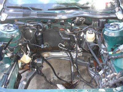

Damn, this is a bitch to get out! And wouldn't you know it, it has one of those clips from **** holding the speedometer cable into it.
Tom

Yeah, I hate the size and the weight of the atx's the most. We're getting the replacement tranny from his wrecked 95 so I will just drop the 95's whole sub frame with everything attached. Then I can just separate the 95's tranny from it and install it in the 93. I have a real nice OTC tranny jack that I need to put new o-rings into that will really help with the R&R of the trannnies.

By the way guys, when I was re-attaching the new VSS and speedo gear housing to the speedo cable, I found that if you have the "spring clip from ****" already installed in the sensor and then push the hole onto the cable end, that the clip spreads out inside the housing and clips itself around the cable housing very nicely.
So... don't remove the clips.
