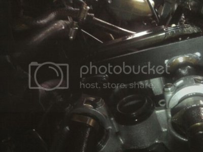

OK, got it tore down to the heads. So I decided to double check the timing before going any further. Tell me that I didn't F#%^# this up! :banghd: :banghd: :banghd:
First step - the cam positions look identical to the pic in the book. The dots are exactly at the upper face of the head and opposite each other.
image.php
Step two - when I set the timing I aligned it based on the book and this picture. Everything still looks the same. The cam sprockets line up with cover #4 marks. I can't see the mark on the crankshaft but I recall lining the dot up with the belt. So far so good.
image.php
Step three - I lined up the crank pulley on the key. Seems like it can only go on one way. But when I look at my pulley I have two white marks. Mine lines up with the mark that is counter clockwise from the other. But this pic and another in the book indicates the other mark should be yellow - and its supposed to line up with the zero on cover #1. Did I screw this up?
image.php

Are you talking bout the 2 marks for the crank pulley on the iming belt? If so, one mark is for the 3.2 (ATX tensioner setup) and the other is for the 3.0 (MTX tentioner st up). IIRC the 3.0 MTX mark is the first one when moving clockwise around the belt. If I have it backward someone please jump in.
As far as timing....on the chain connecting the cams there should be 2 lighter links. These links should line up with the timing marks on the sprockets. This, along with the method you posted, insures that the timing between the cams are correct. If the chain is off a tooth the car will run, just be rough and down on power.

Cam timing can also be verified using the Rotunda cam position tool. It slips onto the flats at the rear of the cam when they are correct.

Forget about the marks on the belt. Line up the dimples of the two front upper sprockets with the bumps on the timing cover backing plate. It's hard to keep one of the cams in this position because it's on one of its lobes, but it's do-able. Then line up the dimple on the crank sprocket with the bump at 5 o'clock on the oil pump. Put on the belt with NO SLACK in the belt going clockwise from the upper left sprocket to the bottom crank sprocket. It is important that there is no slack on this, the "timing side" of the belt. The back side can have slack; the tensioner will take it up and keep the belt from slapping.
Once the tensioner is released to do its job, THEN re-check to make sure that those three timing dimples are still lined up with their respective marks.
On the chain side, make sure the chains are tensioned when you check to see if their dimples are lined up with the valve cover mating surfaces.

Ah, I see where you might have misunderstood me now. The crank PULLEY can only be lined up when the plastic timing covers are on since that is where the timing "CHECK" marks are located. If you're out on the road and want to check timing with a timing light, you use the marks on crank pulley and the timing degrees on the middle plastic timing cover.
The crank SPROCKET, which is what you use to actually "SET" the timing, is under all that foo-foo plastic, has the teeth matching the belt, and has one dimple on the outside face. This method is how you set the timing of the valve train to the crank and is what I was talking about earlier.
