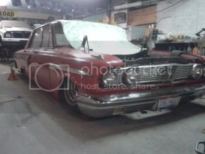

picked up a 64 fairlane 500, bought it with no motor or transmission..have had a SHO motor sitting around for a while, so i figured this would be a different swap to do.
2013 01 23174231
the car is on air ride, its 4 linked, currently working on a mustang 2 swap to make the engine conversion easier, along with better brakes, steering, and air ride options.
Still deciding on what trans to use, was thinking just the a4ld with a good rebuild for just driving ease..this car is pretty much just going to be a cruiser, and i love the look and sound of the sho motors, so it will have a few performance upgrades, but not that many...

Just go with the A4LD. Unless you can find an instance where Ford put the AOD behind the 3.0 OHV Vulcan motor. If you plan on taking advantage of the SHO's 7,000 RPM redline a lot while you are just "cruising", I would definitely tell your tranny rebuilder about the high rpm's so that he can build the tranny AND the torque converter accordingly.
Also make sure that you add an oil-to-air cooler AFTER the oil-to-coolant on the tranny fluid path.

the a4ld is not a very strong trans, so you will need one built as stout as possible to hold up behind the SHO.
on the other hand, the aod will mate right up with the cididit adapter for sbf transmissions and a custom drilled flex plate.

Actually not as heavy as you think..they are only about 3300 lbs and the straight 6s didn't make that much tq and either did the 260 that came in it..
Also does anyone know if I could use the 3.0 ranger steel oil pan with pick up on these motors? If I need to section it to lower the motor, a ranger steel one would be much easier

No, the Ranger 3.0 is the Vulcan, a completely different motor, not even made by the same company.

not much opportunity to make the pan shorter to lower the motor - the windage tray and girdle are quite a ways below the crank. the short (front) part of the pan is pretty much as close to the crank as you are going to get it.

I agree. I cut out front part of the pan to fit the foxbody of mine. I had to extended the oil pickup tube. I added a dual oil filter should help on oil reserve. I got plans of pulling pan and extendeding the side of pan opposite of the starter for more oil reserve. I cut a major part of the k-member out and added a thick piece of steel on bottom of k-member to add strength and let the motor come as far forward as possible. The SHO pan is almost touching the steering rack. Pictures in my photobucket. Maurice
Edit If going A4LD that is what I am using. That trans bellhousing needs some mods, and must use the A4LD flywheel redrilled for the SHO motor. You need a early Aerostar A4ld non computer controlled trans to work. I have wrong one have plans either control with Jeep trans controller or pressure switch on side of trans. [Merkur or other one forgot name] Used that method. Maurice

As far as the oil pan clearance issue. I've done some modeling in CAD and you can definitely knock off 3.5" of height with a dry sump oil pan but that's a lot of work, so it's a give and take deal.
