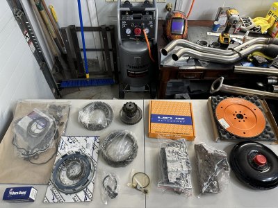

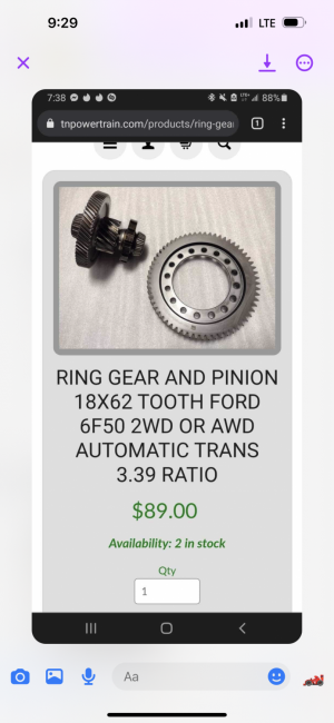

Nothing like coming back 8 years later to say….YES IMG 0720
All that’s needed is the pinion gear set to go along with the ring gear and with some tuning it’s 100% doable! You guys just listened to the self proclaimed internet experts that it couldn’t be done, or that it would cost way too much money and/or it’s not worth it! Why would raising rpm and increasing acceleration not increase performance, in any vehicle let alone ours?
If you don’t care about mpg and don’t need a top speed over 150…what’s there to complain about? Seems like all proven performance gains somehow don’t transfer over to the EcoBoost SHO….according to internet experts anyways
This set is sitting on my table of trans parts ready to go in!IMG 0718

Nothing like coming back 8 years later to say….YES View attachment 89858
This set is sitting on my table of trans parts ready to go in!View attachment 89859
Haters will say it's fake
