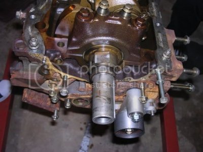

DSCN2139
Bad picture but do you see the webbing on the side of the block?(bottom of the picture) That and something up front will show you.
Someone had a really good write up about it.
I would look into a good way of cooling the engine. The deceased amount of meat on the cylinder walls may cause a problem but it really hasn't been tested. I know you posted about a pushing fan and a double core radiator so go ahead and do it. Should be awesome. :thumb:

Is that picture of your engine? Before or after the 3.3L bore? Did you start with a 3.0L block or a 3.2?

That is my engine with a 3.2 bore.
It is now waiting to be taken to a second machine shop because the first did not have the right machine to bore a 50 degree block.

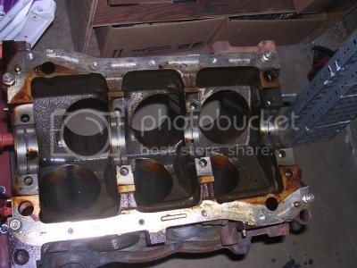

Here is another one.
DSCN2119

adidas_kn said:
Duh I just read you sig. It is a bare 3.2L block
So do you have a 93-95? If not I have heard of sleeveing the engine but that would be a risky and costly job.

I just got off the phone with Doug Lewis at FPS and he says that the engines are 93-95's and that they can't be bored to 3.3L only 3.2L. I will have to check with Josh at SHOnut to verify this. I need to order the pistons soon if I am going to do this.

The 3.0 93-95 are the same block as 3.2 I don't know why you could not. Was he talking about 3.3 and FI factor?

I put these pictures together last year along with the explanation to show the differences between 89-92 and 93-95 blocks.
http://www.ethzero.net/~ianf/engine/stud.htm
