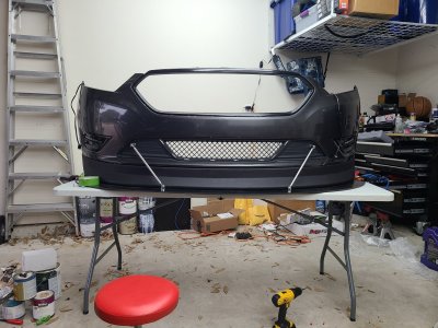

They make them for the 2010 to 2013 . Is there nothing yet for the the newer years? Or can someone make this front end?

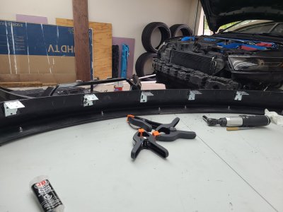

They are made for the 10-12 MY, and can be made to fit on 13+ MY. My car is at the body shop right now having this done.

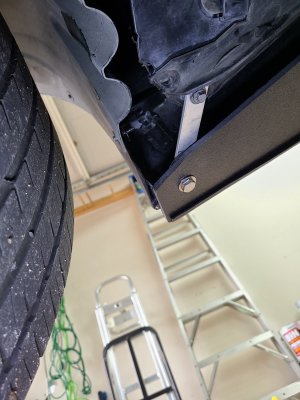

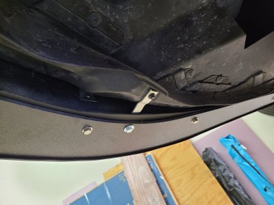

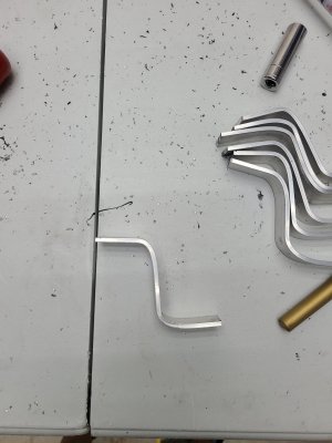

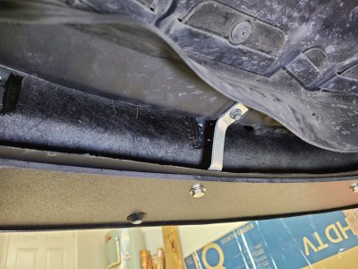

All you have to do is buy the 10-12 and make custom brackets to fit your 13+ that's what I did and I love it.

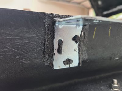

This is how I did mine.
