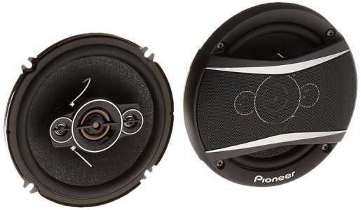

I agree with the previous responses, Lincoln Revel systems are really cool, that's can be a very good choice! :cool: I also like Pioneer speakers, I have these ones in my car for several years and they have nice quality too ;)
71tdHOKzR1L SL1500  768x448
And they weren't very expensive which made me even more happy about their quality :D Alpine and Kenwood models are good too as I know from some of my friends, I also recommend you to look through these examples on cozzy.org for more ideas, it seems that some models in this list are nice too :)
