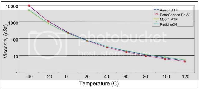

There is a "TStat" for the transmission, also called a bypass valve. Under a certain temp, just like the engine TStat, it keeps fluid from circulating out to the cooler. The trans TStat for the non-PP setup is different from the one for the PP setup. The PP TStat opens earlier, I would have to check postings over on EBPF to confirm exactly how much earlier. But that is an easy upgrade for the non-PP setup to keep the trans happier. If trans temp is triple digits or above (personal opinion), I think you are good to go for normal driving/quick bursts of performance driving. Extended sessions of performance driving really should wait till near/at operating temps.
Taken from comparisons on BITOG back in 2007, temps in Centigrade
temp Amsoil ATF PetroCanada Mobil1 ATF RedlineD4
-40 8820 9535 4708 5111
-20 1074 1052 762 798
0 237 220 200 205
20 77 70.2 73.6 74.3
40 33.5 29.8 34 34
60 17.4 15.4 18.5 18.4
80 10.4 9.1 11.4 11.2
100 6.8 6 7.6 7.5
120 4.8 4.24 5.44 5.36
ATFviscosity
We see normal temps around 80C (176F+) to be in the 10+ range. 40C (100F+) is about 30+ range. So I figure anything at or above a comfortable range for humans in temperate climates is a good rule of thumb for engines and transmissions as well. Not sure why it works out that way, but it does.
