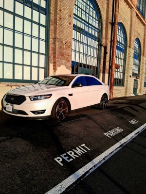

Hi SHO community!
John here, and I've reserved a 2014 SHO 83k miles on Carmax and extremely excited to soon become an SHO owner. I've read a lot of valuable tips regarding the PTU and RDU, but I wanted to reach out for advice on what else I should be looking for.
Looking forward to hearing from you, thank you!
