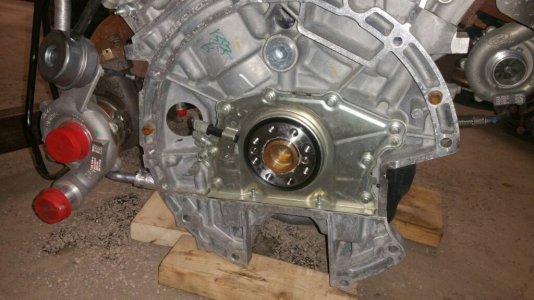

Just a small update, got all my sensors and coils swapped over, the crankshaft trigger wheel does need to match the sensor it is designed for. The 2010 engine trigger wheel has less teeth, more spaces than the 2016 wheel. Got the converter seal and left axle seal changed. Got the engine and trans bolted back up and up in chassis. Found out 2010 flex plate has 4 holes, 2016 flex plate has 3 holes. Found this out when I went to bolt the converter. Dropped it back out. Swapped to correct flex plate. Reassembled and back up in chassis. Pulled the bumper, condenser, radiator and cac. Cac had some evidence of metal after I drained it of oil. Gonna bring it and the radiator to work Monday and flush it them out well. The new engine uses specialty orange, the old used specialty green. Going to do a complete flush without the thermostat to the cooling system to prevent cross contamination. Subframe is back up and top end is pretty buttoned up. Just need to replace the bank 2 wideband as the turbine whacked it when it broke.

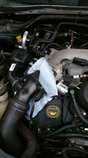

Radiator, cac condensor and fan back in. Both widebands changed. Cleaned and swapped the heated pcv valve and intake fitting so no possible mil. Ol Smoky is alive. Filled and purged the oil filter, then cranked 6 times with injector harness unplugged to build oil pressure. Fired right up, started it a couple times, but no coolant in it yet incase it had to come out again, so not run long. No noise, no misfires, No initial mil light, still need to run koeo and koer, reset Kam and mfm. Just need to change the booster hose end (the later style is a quick disconnect) and front breather tube as the port is in a different location in the front v.c., plug the reservoir port in the valley tube, and clean 2 more cac tubes I left in the trunk., flush the cooling system and change the tsat. Top off trans.. toss the bumber on. next up machine the rotors, change the brake fluid and diff fluid.... And wait for snow... Boosted Awd Fun

The harness connects at the back side of the sensor. The sensor is located in the rear left side of the engine (front bank in a transverse mounted engine) behind a rubber grommet, behind a heat shield where the engine meets the trans about 4 inches above the oil pan. The sensor is only about 4 inches long and only has a connector on it. No wire harness. The loom passes through the grommet into behind the flexplate/flywheel. Basicly behind the front turbo.
Sent from my SAMSUNG-SM-N910A using Tapatalk
The access hole is on the left of the photo and the sensor on the 2016 is gray. The 2010 is black83777da7f6ee06ec53aa054037746bab
