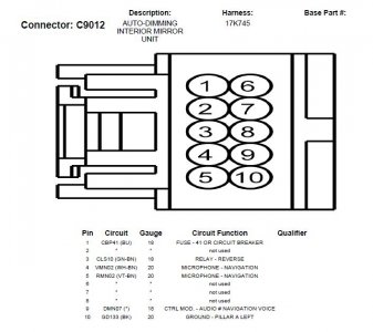

Anyone have a good idea which fuse belongs to the auto-dimming mirror... It's not in the manual anywhere...
I've read some other forums and info and tested it, it seems to not be working at all anymore. It WAS working less than a week ago...
n0ttsweet
Apr 20, 2017
Dealership said its Fuse 41 inside the cabin
for future owners...
