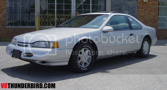

Swap a 3.2 into a Thunderbird. Instant(ish) 2 door SHO and rear wheel drive.
If going into a foxbody T-bird. You will have the same nightmares I have had. I agree would look nice. My bodyshop buddy [one going to do my car] Made a 4 door Ford Fiest, a coupe Corvair, several dual tire mini trucks and several v-8 Corvairs. So anything is possible. Like pointed out money and skill. Maurice
He meant the next generation, the MN12. Very similar styling to the gen 2 SHO. Too bad they're close to 4000 lbs. The Supercoupes even had the same seats as a SHO, but with a tilt forward function so passengers can get in the back.

Weight would be a problem. But turbo would help in that area. Unsure on the next gen. I know on the next gen Mustang the crossmember is almost identical. So unsure. Here is some pictures of what I had to do. I wouldn't go with A4LD maybe c-4 or AOD with the SHO adapter plate. Maurice

Edit so that is what a MN12 is. Learned something.
