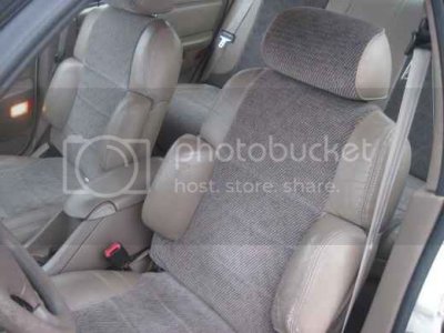

My 1990 needs new front seats.
I want to know if any other Ford products have the same seats, or if they are only found in SHOs.

Don't leave out the 89-90 or (91?) Cougar xr-7 those also had similar front seats like the SHO.

I stand corrected. I've never seen SLOs with those seats, fabric or not. Huh. Anyone got pics?

My front seats are actually from a '95 SC (36k!?). It DOES suck not having map pockets, though, but it's pretty convenient with grabbing something out of the back!
Be careful with what you choosel; the SC headrest DO NOT fold forward and the seat track mounting brackets where different spacing (floor and cushion bottom.) You will want to swap those two...
