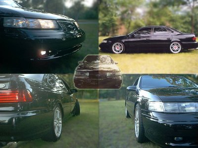

click on RI-SHO's sig pic. it goes to his site, and IIRC, he has pics of his old gen 2 on there with 18s

Here:
RI SHO3
I had 18x8 Team Dynamics with a 40mm offset and 235/40/18 tires and "little" drop :cool: .

Whaaa! I miss RI-SHO's car! And I never saw it in real life...What a beauty!
