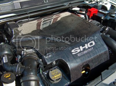

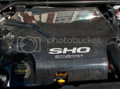

...delivered a custom carbon fiber casing over the entire engine cover.
002
Nice! now...the most time/money spent was making the mold/tool to lay-up the final part. Do you own the mold? Do you have the mold? If it were me, I would have the mold in hand!! Then others could benefit. NESHO or SHOsource could have more pieces made!!

There is no mold. Period. This was all hand laid & hand sanded. The 'SHO/EcoBoost' logo is custom cut out of a metallic white vinyl, then 4 layers of clear were shot over the entire surface.
If there was a mold, believe you me, I'd be establishing proprietary rights over such mold.
Like the thread title reads....... "One Off".
There HAS TO BE A MOLD! There is form to the part! There are flanges! Carbon Fiber, just like fiberglass, comes in a roll, then a 2 part resin holds it all together. IF it was flat or just curved, any form would work as a mold. I have used a section of a 55 gal drum as a form/mold for some prototype parts. Some mold release, some 5mil stacked wax sheets & bondo as a radius made my flanges. There just MUST be a form he laid it up in!

Nope there's not. Foil on original cover, CF hand laid over that, resin hand laid, sanded, sanded, and then more sanding. Vinyl applied and then cleared.
Part of the delay was due in fact that he didn't have a mold. This was his fourth go around at it. We changed up some things for the final attempt due in part to the troubles he was experiencing during the first three attempts.
It was certainly a process indeed. Which I completely understood. It was only at the point where he ceased all communication did I seek out relief via the criminal complaint route.
But it's all good now. This will be (at least until someone else may decide to attempt something like this for themselves) a unique, one-of-a-kind mod.
OK, thanx. I'm surprised it came out as well as it did since he did it backwards! So its basically a duplicate of the original. Would of been SO much easier & faster if he just cast the original after applying off-set wax to it. then it would be duplicate-able!

It would be easy to make a mold off the oem engine cover and do a layup,mmmmm maybe I will look for an engine cover and experiment. Havnt done any CF work for awhile at home.
