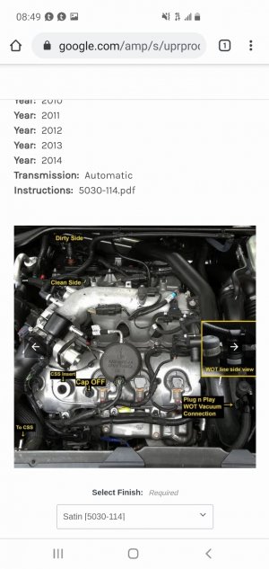

I have not. the front isn't capped off on the UPR though, the oil cap becomes the secondary baffle.
I see, I just mis interpreted the pictures on their site, there is a CSS insert that goes into the oil fill and they just don't have the lines connected and the CSS on in the picB89c7316dc866438d6c5f6898fb779a1
Correct. The top portion and lines are not installed there for some reason.
7,405
9,701
As discussed from the other thread.
From UPR:
The Clean Side Separator (CSS) needs to be installed, but first we must cap off the front PCV port. The CSS allows the engine to breathe through the oil fill neck, so the PCV port is not needed. Use the supplied capped fitting and connect it to the PCV port on the front valve cover.
From Me:
The CSS insert is just a big oil cap. It has mesh and filter media to keep the air from the crankcase clean (while acting like a crackcase vent) where it joins with the clean intake air their way to the CC. The oil caught in the CSS reforms and empties back into the engine, not needing another can because it has not been contaminated.

Hmmm, weird. I have the UPR catch can setup as well and I thought I bought it with all the bells and whistle, but mine connects differently, per their instructions. My clean side is identical (IM to drivers side port on CC), dirty side is identical (rear PCV to top of CC), but the WOT side is different. I had to tap port I had to make right after the air filter (I tapped underneath the tube of the AirAid filter) a connection they gave me that goes from there to the passenger side of the CC.
y4mK59pzrB-azqFKjrcAfvOlO-zDCLNwz_Oj1F9mRdT2Xx5sBikX2YIj-1dynVb0OsOMAvxxPfPZ7eRuubphAUeGDhpl106oTJnIuSVrx560nqVWq8j4Ox7yE28YwkklI39n8ZMFvM2oI7jQlEW1B7FyTcQk1gD0vTr1RDjhS0A9D5R_z1TSO-SN_QfAnxg3OF47yec-_yUWj0slcAvxXOwUw
y4mfO81WKnMh5IB_DiD0gkAagFfj64F40JcNE0Qg9S15YI6lhvgJ6EA1Uobn0emhNY9nOhICcpRy-uDpBuR85vqm4zUudyU5lgDljm2dPBuZD2S4t_QtHIiw96X-uhnoMmzNaLrnukraTFVhskKBnYcGFGNEKQfoinhLjAqX-Q8j-45w11bYdycb0Qoqav151nMZNsv3HhNF7KcWzqMR6DO_w
But I still have the OEM front PCV line that goes to the connection new the front OEM BOV port as well as the OEM oil cap.
y4m3Alya70MhQPSg-2y9vYnGHYn-Kwru32MCW-rzg8gkKVUwvyFppdOnyVZ_bgHJA1jrdSDfnD8kqmJz90eQQGxDyQnyAQYnO1e7aCp7EuU3eKQHFlcFSc9wh7QX1EQX6GZc1VqYzAno4NpDDZyFKVvd8aGhNjdSkI2jV__DnuPwnd1NEuuz1banqWpxIRyFC3bqXScLoFZ9aLKku_19a-hSw
Am I missing something? Do I not have the "dual valve" version?
