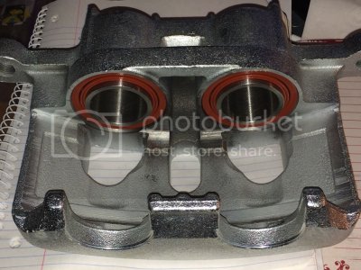

Sorry for reviving an ancient thread. I'm delving into a front brake upgrade and am switching to the PP calipers in the process. Wanted to chime in for others that may run across this thread to clear up some incorrect information.
The master cylinder change came in MY2013 and applies to both PP and non-PP cars. There is no difference between the PP and non-PP cars. The ONLY brake difference between PP and non-PP cars that I can find are the calipers and pads. All other part numbers are the same when comparing my MKS to a SHO with PP.
I have a set of PP calipers in my possession...
8F9B86C5 20AE 4D83 B827 EE588789B7D8
They are literally the same casting as my non-PP calipers. So, there is not even a body difference. The only differences I can see are the pistons and the seals.
Where it gets confusing, as mentioned previously in this thread, is picking the correct brake pads. I think the pads are all interchangeable. The PP cars pads are of a different shape and friction material, but they are riding in the same caliper casting on the same rotors. I'm not sure why Ford chose to change the pad shape. I suspect that they were able to have more contact patch for better clamping force thanks to the better heat handling/dissipation of the improved caliper. But, I don't know why some pads have metal clips riveted to the backside and why some don't.

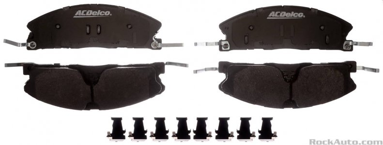

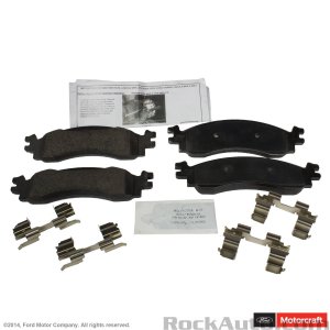

Courtesy of Rock Auto, here's one style of front pad listed for PP cars...
AG1Z2001F ANG
Here's another style...
17D1611AMHPV Primary
Any idea of which style is better? Does it matter which style I pair with the PP calipers? Looking at Rock Auto, there seems to be very, very few that are the top style. Even the pads spec'd for use on the Interceptor Sedans show the pads at the bottom. So confusing. LOL
AG1Z2001F ANG
Yes, im confused as well. I was doing brakes on the wifes sho and ordered some hawk pads. Did alot of research to make sure i got the right ones. Well long story short, the ones i took off looked like your bottom pic (referring to the tabs) and the hawks looked like the top pic. But the hawks were smaller. All this time we thought we had a non pp.....i wondering if we have one now?
AG1Z2001F ANG
I hate to revive such an old thread but the two different pads shown in the pictures are definitely not interchangeable. The top style is for the 12.8" rotors whereas the bottom are for the 13.8" rotors. I just found this out the hard way when I ordered some Hawk HPS pads for my 2015 non-PP. I received the top style when I guess my car is fitted with the bigger rotors. Hope this helps someone. Looks like I'll be overnighting different pads.

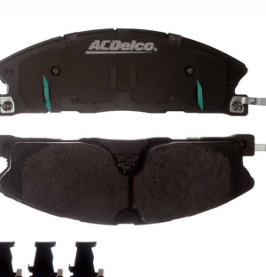

Had to dig this one up bc I am having issues with noisy pads, they are squeaking on decel 20 mph and lower, and yea they've been bedded properly, 3 or 4 times now.
I highlighted these little dimples in blue, I thought these were odd as they make contact with the out edge of the pistons. But the old pads I took off had the same dimples and same indentation from the pistons...
I took the new pads off after a week and noticed the top portion wasn't making contact with the rotor so I ground the dimples off. Now pad makes full contact and I re bedded them. Still same damn squeak.
Does anybody know what is up with the dimples and the contact being made with pistons?

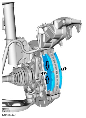

Best guess is that the pads with the dimples spread apart are the outer pads and the pads with the dimples close together are the inner pads.

Great diagram, ty.
The outer clamshell of the caliper has slots for the middle of the pad, the way it's configured now fits the best. I'll take it down again tomorrow and see what I can figure out.

Verified on my car that the outer pads have the dimples farther apart. They don't contact anything, just indicate inner and outer pad.
