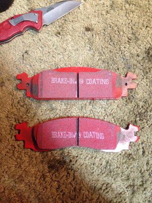

Rotors are the same. The only difference is the pads 8dbd89d7186b91602855b1c733508fc5
These are ebc red stuff from when I did my brake job.
Top is non pp
Bottom is pp

So everyone, I've confirmed... Rotors and rear pads on PP and Non-PP are the same. Front pads are different as shown above, however, they ARE interchangeable.

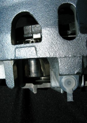

The pistons themselves are crossdrilled like so (pics courtesy of MT):
Cutaway Caliper drilled piston
Cross Drilled brake piston

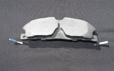

and the pads look like this:
Ord Taurus SHO Performance Package front brake pad
