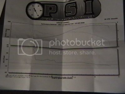

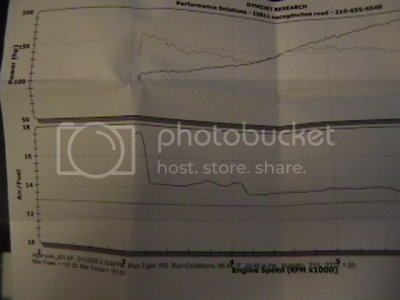

I have some proof of what NJSHO said.
I went to the dyno a few weeks back, and noticed that things were on the lean side till about 5K.... then it started to richen up.
A/F ratio:
337c5cee
Ae5964b7
Im running a 190LPH pump. So it seems this pump is the border line. Im actually going to look at getting an ADJ. FPR as well. Im sure alittle tweeking with it should net me some ponies.
