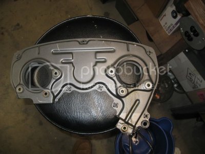

I agree, clean everything up then look for the oil trail. Yes the rear-most seal is behind the cam sensor, then behind the part seen below. Sure signs of cam seals leaking:
