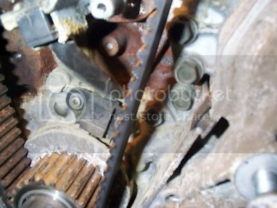

I've seen 2 of them fail directly (failed while I was driving). Intermittant stalling and missing. Not starting after stalling for 20-30 minutes...typical.
Those both looked like this...
CPScalcium
A new CPS, Timing Belt and Water Pump ensued.

If it's not due to coolant, maybe road salt? Or other contaminants, that whole area looks pretty dirty, maybe try cleaning the vanes? That yellowish/orange residue at the top of the pic definitely looks like coolant.
