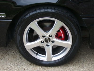

To be honest im not sure if they are mustang calipers or not. The previous owner put them on. If memory serves me correctly he said they were specified for a corvette. Here is a picture if that helps any.
Pictureofwheels135
13,266
I think all you need is the caliper brackets to move the calipers out to accept the 13" rotors. Are those 17" wheels? You'll probably need 17" wheels to fit the 13" rotors behind them. Shonut used to offer a kit for the rear 11.6 setup. Check with shobros too.

Those are the Cobra calipers. If the original holes for the bracket are intact, you can just use those holes with the 13" rotor. Otherwise you might need to buy a new bracket.

That PBR caliper and pad combination has a noticeably smaller swept area that the '96 caliper and the PFCM 0598-20 setup. The red SHO'd calipers are much better looking though. I have been very pleased with the stopping grunt of the 96/PFCM combination. Once they get a little warmth in them, they use all of the tire's traction with only moderate pressure on the pedal. Replacement parts are easy to buy through any auto parts outlet.
