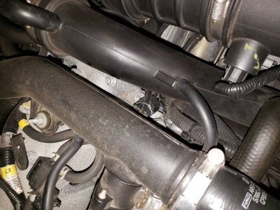

There is a wire that runs long the top of the engine to a sensor. Often it can wear and short against the block. There is a whole thread on that here somewhere. I'm sure others might chime in with a link to that thread.
I took a photo from mine and you can see where I tied the wire to keep it off the block.

Mm Can you circle it? im not to sure im sorry lol

smack dab in the middle of the pic with a thin white wiretie type thingy.
I looked and it's not touching. The only reason I brought it up to see if others have this problem as well. Its been happening to me on my old motor and the new one that ford installed.
