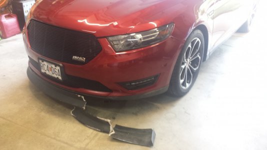

How important is the part that covers the motor/trans? Mine met it's demise after an altercation with a 'fenderburg'. (ice chunk) One hold down is broken and cover is cracked pretty good. Does it need replaced or can it be safely run without?

Ran my last SHO without it for about 30k. Didn't make it in my unplowed driveway on the first attempt. i backed up to try it again and the shield shattered as it ripped off. I have the shield on my current SHO and plan to modify it to send more cooling up to the PTU. I believe the Flex or Explorer comes with that design.

I recently had to “rebuild “ mine. Hit a snow berm,split it in the middle and nearly broke out one of the rear fasteners. It did pull both the clip nuts out of the frame (the rear 2). I was able to get the clip nuts from ford, and used 2 part epoxy on the cracks. Seemed secure, we’ll see how good the epoxy holds. I did price a whole new unit while there and it was just under $200.

Look at it this way, anything bouncing down the highway that the shield took the impact from would have hit the engine without it. I say this after a similar event with mine involving a large chunk of firewood/4x4 last year that emerged from under the car in front of me on the highway.20210618 184009

You can drive without it, but I would get one as soon as possible.
It''s a lot safer and better for the engine and transmission to have the undercover. A lot of newer cars have undercovers for a reason.
Here's why:
if something kicks up into the engine bay while youre going down the road, and god forbid if it hits the turbo oil lines or whatever other sensitive parts under the hood, and causes a major "quick oil drain" while you're going down the road, you will wish you had the undercover. Also, if you run over something, the cover will take the impact, not the engine.
The other reason why it's beneficial to have the undercover is aerodynamics. I'm not only talking about fuel economy, I'm also gonna talk about air flow and cooling. Often, people think not having the under cover will improve engine bay air flow and cooling, but that's not true. The undercover will make the air flow smoothly through the engine bay. Air will come in from the grill, through the radiator, flow through the engine bay, and smoothly exit out of the back of the under cover. Smoother air flow will also improve fuel economy during high speed driving. Without the under cover, the air flow will be disrupted, and I don't know why anybody would want disrupted air flow.
There's a reason why the engineers decided to spend money and design a under cover for our cars. There's is a purpose behind the covers.
If I were you, I would try to find a used undercover, and I would slap it under the car.
I personally am not really worried about the air flow aspect, I'm more worried about something potentially impacting the engine, instead of the under cover. I've had multiple instances of something hitting the undercover while I was going down the interstate. My undercover is banged up and scratched up on my 2010 Taurus sho. I'm glad the undercover is banged up, instead of my engine.
