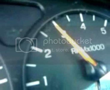

1. at cruising speeds the rpms will flare up as if something is slipping but it does not flare up and down quickly you only even know it is doing it by watching the tach. after the cams have been welded i think i am going to hook a scanner up and see what the computer sees going on. as far as i could tell it was only doing it in overdrive and more so at higher speeds.

it does it even when the ac is shut off. my sable does the annoying ac thing and this is way different. it fluctuates about 500 rpms and goes up and down very slowly a few seconds to travel 500 rpms. i took a video that i will try to upload later.

it was a pretty constant thing. traffic was kinda heavy so i didnt get to use the cruise that much to keep it steady. like i said though you coudnt even tell it was doing it except by watching the tach the car would not speed up or slow down or **** at all.

That really sounds like the TC locking and unlocking with directions from the climate control system. Try turning it to 'vent' and see if it goes away. There are only 2 settings where it does not happen, vent and one other I always forget.

When the TC locks up there is ~300 rpm change. It will happen anytime the climate control is in anything but floor and vent and at highway speeds. It will happen in 3rd too. But the rpm change is higher.
