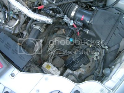

Take the battery out and take off the battery tray. Not an easy task to get that tray out though. The lines are under there. I've got pics I'm posting up now. The lines run right down by the subframe and you can see them. Also if you take off the front bumper you can see the "tiny" factory trans cooler.

Engine shot with Battery and battery tray removed.

And here are the two lines. Hope this helps.

Well... I had this all torn apart when I installed a Gen II ATX cooler as per Nimz's recommendations and just took pictures of it all for reference for me, and whoever needed it in the future. Good luck with everything.
