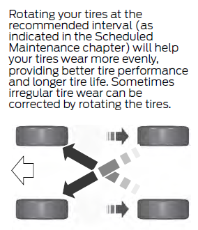

for being a gear head all my life there's always been a debate on tire rotating. differing opinions, money hungry shops selling unnecessary services, front wheel drive, rear wheel drive, all wheel drive. lets settle it. I was told cross rotating (rear left to front right, rear right to front left, etc.) causes the tire to separate and will destroy the tire, I've seen this happen myself selling used parts, people buy a rim, use the tire that's on it, come back complaining the tire fell apart when I didn't sell them a tire. so the rule for a long time was tires stay on the side of the car they started on. but good ol google says AWD cars should use the cross rotation pattern. so who does what? these tires aren't cheap and the car sees triple digits somewhat regularly so the last thing I want is a tire coming apart. so here are the questions I'm trying to ask:
cross rotation or straight rotation?
how often (mile intervals)?
do you balance the wheels every time?
7,522
In the early days of radial tires, it was important to keep them rotating in the same direction when rotating the tires, that is no longer the case with good quality tires. In terms of tire wear, the cross rotating pattern is best, so as long as you have decent tires, cross rotating is now the preferred method.
