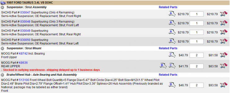

I am going to be replacing my struts, springs, and bearings and some bushings all around.
The List:
- 4 SACHS SARC Struts
- 4 Springs (RockAuto doesn't have any selection, anyone have any recommended springs to go with?)
- 4 Strut Mounts (Front with bearings and 2 backs)
- 2 Front Wheel Hubs
Am I missing anything? First time doing struts so I'm not sure if there are some other small parts I need to replace as well.
Pricing:
HuOd3
Thanks!

SHO Source has Moog and their lowering springs for the Gen 3:
http://shosource.com/catalog/index.php?cPath=61_3_31
You will also need coil spring insulators for the F&R (different) for the bottom of the springs.
The rear strut mounts act as upper spring seats, but you will need upper spring seats for the front. They hold the strut bearing in place, also.
When I got my front mounts & bearings from SS, it didn't include the front upper spring seats, which they sell separately for '89-'95s. Rock Auto or any of the other usual parts outlets should have them. Usually a day or two wait, but one local store here got them the next morning.

Thanks for the tip, added it to the list!
What about the inner and outer tie rod ends?
I changed those a year or so back, I think they are still good.
