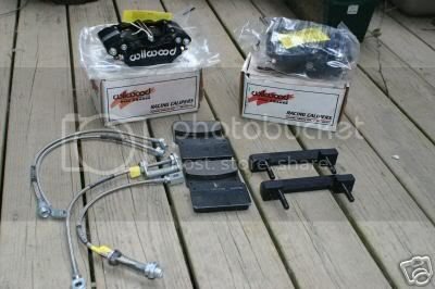

I am not using these right now but I got them off ebay at a ridiculously cheap price for what they went when new.
Here a pic of what they look like. They are the TCE sho stopper Jr kit. I am pretty sure these were the cheaper pair. (when offered)

I didn't realize Todd ever sold any kits with those little calipers (radial mount... interesting).

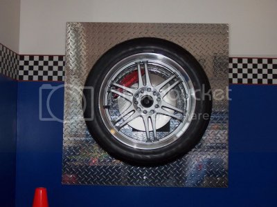

Tim,
Once you upgrade, don't forget to recycle your old parts. Here's what I did with the BSL calipers I pulled off my car!
The setup is mounted on a rear hub so the whole assembly spins. My 3 year old son loves it.....it's in his room. For some reason, my wife didn't want it in our room?? :)
