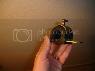

DSC01147I don't know how familiar with the parts of the front end, but look for a pair of these on your swaybar. IIRC, the OEM bar doesn't have the fittings, but if you bought the car "certified pre-modified," you may have them.
If the stock bushing has a threaded hole in the top, you may be able to screw a little grease fitting in there. If not, you can replace the whole bushing (go to SHO NUT )
I have Energy bushings on mine, and to get a 90 degree fitting on there, I have to drop the back end of the subframe. I think I could get a 45 on there without a problem.
Of course, the noise might not be from the sway bar, in which case, disregard this entire post. ;)
