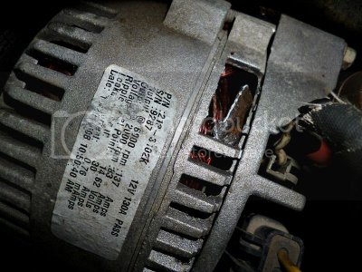

Well I was planning on getting a cam sensor, but I got the urge to start up the car one more time and see how it ran. I gave it one good rev (fairly high RPM) and the damn alternator exploded. I'm talking a broken casing and grinding, aluminum chunks splattered everywhere. Just my luck.

Haha. There is a bunch of bound up metal shining in there right where the fins are missing on that casing.

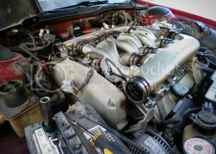

Time to swap cam sensors.
P1000693
At least the sensor is easy to get to! !!! (my hand says otherwise)

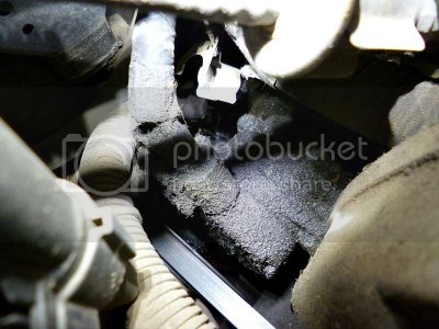

P1000689
Yep, looks like shit. It's got to be bad.

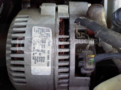

Oh, and here is a random chunk flying around in the alternator. :lol:
