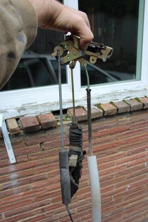

Here are the guts
Sho tech latch assembly
Here's the contributing factor to why my latch stiffness issue, which culminated in the door handle breaking:
Sho tech latch spring
So I cut off a coil and a half of the spring to reduce the tension. This part is used in the child lock assembly. I'm not sure why the stiffness occurred, as it is very unlikely the spring is stiffer than when it was installed, but apparently the whole system has been affected, so I just weakened the part I could get to.
