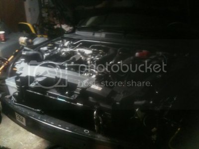

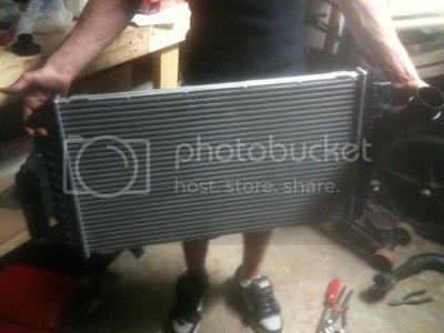

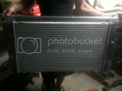

I will have to do the bumper write-up this weekend as the pictures didnt turn out too well sense i took them on my phone, but here are some of the pics that turned out decent from my phone. :munch:
This is the factrory intercooler...

This is a pic of the intercooler mounted to the radiator...

And this is it all tore down, ready for the new radiator to go in...
