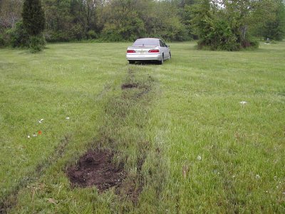

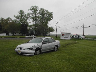

Thanks for all of the great replies. The more I drive the car the more I am noticing a slight pull to the right. It's not bad, especially considering the way it was before. This car was actually airborne for a split-second. Maybe only a few inches, but airborne none the less. It slammed into the ground and took up some turf.
DSCN1747
DSCN1748
I was forced to start driving it again when the transmission started acting up in my 93 last year. It's been struggle to get it back in shape ever since. Driving a car that needs work is never fun. I'll have to check the sub-frame alignment at some point. I should have done that and taken the car to the alignment specialist that I have always used in the first place. I went to a local Firestone to save me the trip, which will now only end up costing me more money. Oh well, a reality call was in order I suppose. I sometimes forget why I don't like anyone touching my cars but me. If I only had an alignment rack in my garage...
On the bright side I've been learning a lot about one of my least knowledgeable automotive subjects, alignments.
It’s time to find a winter beater and fix her up proper. I'll be happy when the SHO looks like the day I bought it.

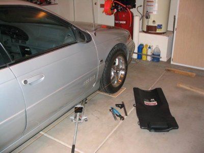

Home aligments aren't that hard. The only special tools you need to align a SHO are a caster/camber tool (anywhere from $120 - $300, I've been using an economical one with very good results), and place to park it where the car will be level.
This is the caster/camber gauge that I use:
http://www.racerpartswholesale.com/polpos.htm
There are cheaper ones available, and more expensive ones as well. RPW also has a little one for about $40, but I have no idea whether it's a PITA to use or not.
Here's a pic of a really inexpensive conduit-and-string setup that works nicely on GenIIs for setting toe:
108 0874a
I put grease between two 12"x12" pieces of white board and put them under the tires. This stress relieves the joints so that you're really setting alignment and not just putting load on the tires.
So for about $180 you can have adequate tools to do your own alignment. I've been doing mine this way for a few years and have gotten better results than I ever got from alignment shops, IMHO.
