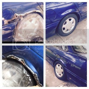

Thanks for the warnings guys. I do live in the salt belt as former pics of Ginger..named for her orange hidden undersides.. will attest to. I didn't get any parts yet, I'm working on wheel wells and letting my foot get over the bout of gout. Then I'll give it a try. I don't like hearing what someone else said that those monroes will raise the frnt end a bit, that sounds like they'll just be harder to get in place. Bob has tokikos and they look nice. I haven't driven it around enough to notice how they ride since there's still that shifting issue and I just did those wheel wells too, they were nasty!
