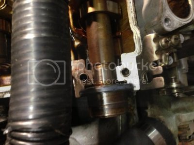

I had the camshafts TIG welded by a friend of a friend who does welding for the railroad in NC:

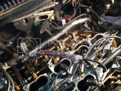

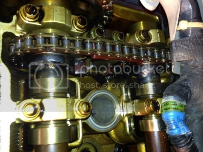

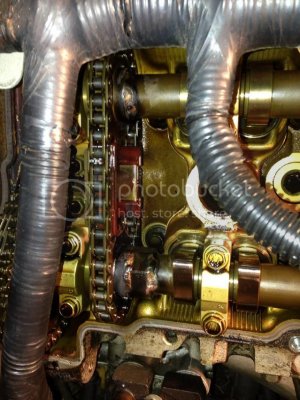

After getting car back home, I cleaned the visible parts with the cam covers off. Replaced the camshaft seal by the water pump. Replaced all plugs with new Motorcraft spark plugs properly gapped. I busted the ECT, so replaced with a new Ford one. I replaced the spark plug well gaskets and valve cover gaskets with new ones. I wrapped the harness that goes nearest the firewall with heat tape, good to 1000F (I don't believe it but it's better than nothing!).

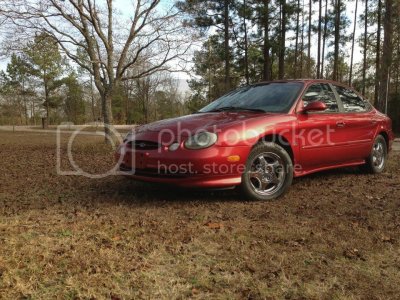

I installed new wheels from the junkyard and put new tires on the car. Installed new Motorcraft ball joints (needed to make the LCA red hot to get the tapered seat out!). 400 miles later, minus an oil cooler that leaks a tiny bit and misc other stuff, the car is a safe, reliable car.
397020 660585800619 485342782 n zps202287a5
I guess that was my Christmas gift this year. A misdiagnosed, good condition, good running, V8SHO that had its mufflers removed :)

I need my V-8 welded too. Where in NC is the guy who did yours?

Re: person who did my welds...Guy that did my welds is a friend of a friend, he lives in Lancaster, SC (south of Charlotte). He does not do pulling of the valve covers, you gota bring it prepped to him. Just bring a battery to bump the starter. Cool guy. If you want his contact details, let me know!

I'm in WNC but would drive there if he'd let me take it apart.
