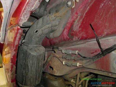

Does this help?

The hose is meant to drain off any acid that may overflow from the battery. It mounts to the bottom of the box and routes out to the drivers side inner wheel well.
The plastic panel is common to all SLOs for your generation.

Thanks for the pic. I don't see the hose I am talking about though. I removed my battery tray some time ago to give me a little wiggle room for the air box and "porterized" inlet tube. I know that underneath the battery tray there is a black bracket that the tray bolts to, there should not be anything on top of the black bracket. The people that installed the transmission in my car obviously routed the hose/metal tube wrong because there is a bracket attached to the metal tube that has a tab with a hole in it that looks like it should be bolted down somewhere.

Thanks for the pic Paul. The hose is a bit larger than that and is going toward the front of the car. The way it is now, it is going along the top of the battery tray bracket, and at the front edge of the bracket, turns down to the front of the car. It is about an inch diameter hose and metal tube. I will try to look at it again this afternoon.
