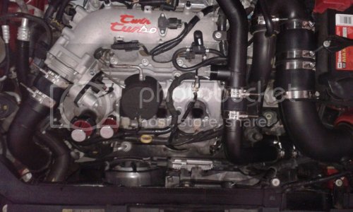

The little K & N's are breathers. Instead of venting the oil gasses into the intake, they vent into the air and oil is captured in the breather filter(s). The one that is mounted in the Oil filler cap has a second filter on the other side.
Hot pipe install took about 3 hrs, including all the HD clamps I replaced on the CAI. Finished it Saturday.

They are larger than the factory pipes and the best thing is they have silicone ends to connect instead of rubber which after awhile tear and bulge causing boost leaks.

Not only larger, but also eliminate several of the kinks/crimps/bends throughout various areas.
Thanks once again to 4DR for pioneering the development of this individual mod. :thumb:

Your K&N breathers do you ahve a part number on them, or info where to purchase. Went to K&N website couldnt find them. Thank you.

EcoBrick do you have a part number on th K&N Breathers. I looked in there website and couldnt find them.
Thank You
