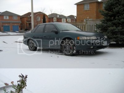

My winters are 225/60/16s on slicers. Lots of sidewall, looks like a Monster truck...
IMG 32982
:doh:
