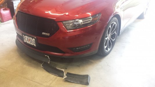

Mike (bpd) color matched his, I recently hit a log and destroyed my chin spoiler but was able to fiberglass it back, gave it several coats of Rustolium truck bed liner to keep the rock chips down, and top coated it with SEM trim black. I want to do the rest of the lower panels to match but I want to have extra retainers on hand as they tend to break on removal.

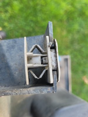

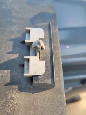

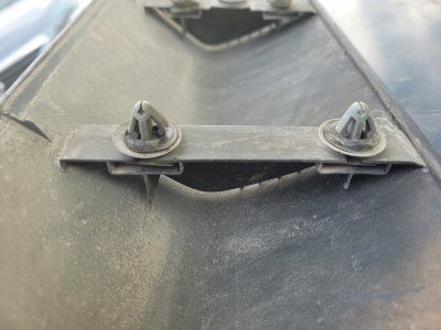

Alright, I was able to remove the door and rocker panel moldings intact, got things painted and back on. Johnbigdog, those particular clips are not used but I did take pictures and will edit things in (laptop took a dump, so I'm making friends with my tablet for now).
As for all (4) door moldings, it looks like they use p/n W715201-S300 and one really strange metal small pin style.
Bottom of the rocker panels look like these-W716350-S300.
The upper retainers on the rocker trim are unlike anything I can find listed on line, but considering my cars daily driven and 8 years old, with a little patience I was able to get all released intact.

Trying from my phone. 1st-bottom rocker, 2nd- upper rocker, 3rd- all door panel trim panels

Chin spoiler repair and trim shot with SEM trim black.
