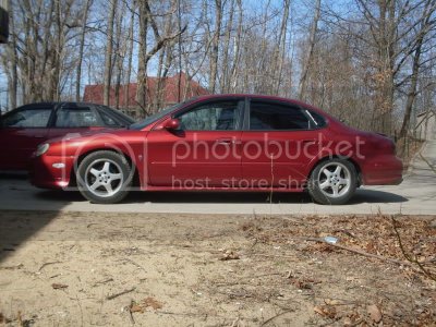

for what it's worth, i went with motorcraft struts and the cheapest strut mounts i could find from a 2002 taurus ses. i then went to tire rack (which is about 20 miles from me) and told em i wanted eibachs from a 98 taurus se. bolted everything together, and aside from the vastly lowered ride height even compared to the factory stuff with completely blown SARCs and two broken springs, the ride quality is so far better than stock that to me there's no argument. if/when i ever pick up another gen III, i don't care what the mileage is, the first thing i'll be doing is replacing the suspension with the OEM/Eibach setup. and let's not forget to mention the wicked stance...

...aside from the vastly lowered ride height even compared to the factory stuff with completely blown SARCs and two broken springs...
Do you have a picture of the new ride height, or a measurement fromt the center of the wheel to the bottom lip of the fenderwell? I've considered the Eibach springs, but I scrape my trailer hitch on the way into the parking lot at work with 4 guys in the car, so I'm very hesitant to lower it any further. I will likely keep my stock springs (as they don't seem to be broken) and go with the '00+ struts. Both (stock non-SARC) rear struts are leaking. :-/

When I went to the Eibachs the rear end height did not change. This was due to the OEM springs being all saggy and worn struts. You can easily raise the strut in the knuckle to actually get the rear end up higher an inch or so.
