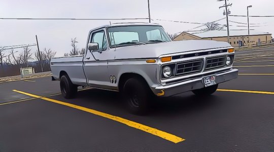

(Some pics because everyone loves pics)
2uo9TDe
My 78 F150
