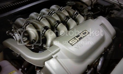

Damn. I wish my engine compartment looked like that.
Whad'ja pay?
