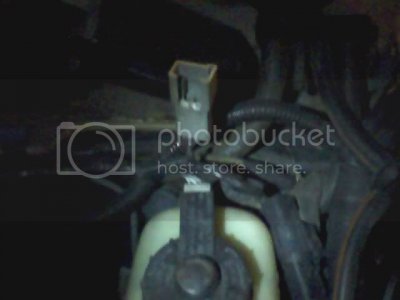

#1 - Near the coolant reservoir, I assume this is why my "low coolant" light is on, even though the coolant isn't low. I don't see another connector to plug it into?

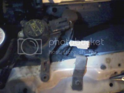

#2 - Grey connector near the firewall, above the reservoir.

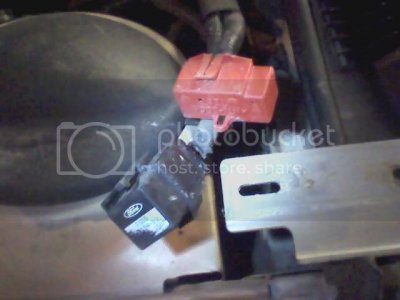

#3 - These are just tucked behind the shock tower. I know these aren't supposed to be connected to anything. Obviously the red one is the ABS test plug, but what's the black one for?

I can be wrong but number 1 looks like the front crash sensor (airbag)connector
number 2 is unused and 3 is a relay (I think its the A/C relay but unsure)
For your low coolant light , Grab another low coolant sensor , they sometimes fail.
Although I played with many harnesses , some of these connectors look alike...
