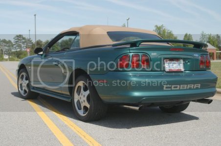

my Cobra is a 97, convertible. It is Pacific Green, 1 of 365 PG with saddle leather interior. It is fast. Not near as fast as the 03-04 Cobras, but still fast.
