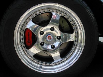

Yeah, I'd go with slotted over drilled. I've had both on my truck, though now I'm running slotted only:
Red brembo 800
