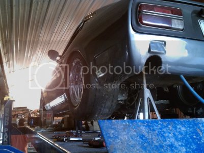

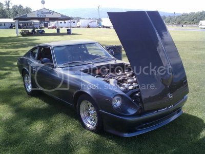

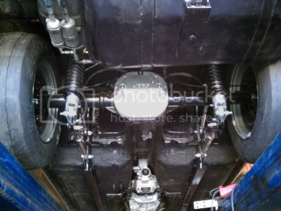

oh and i guess i should post pics of how it looks now, since i posted the last thread in the dyno section i have made some changes to the car, the independent rear is gone and in its place is a ford 8.8/9 inch hybrid with a 4 link and coil over suspension, i was always breaking or bending stuff in the old set up, now its rock solid, also the wheels are now weld drag lites. here are a few photos.
40e1dba1

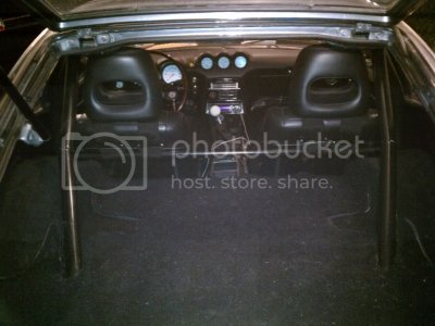

and as you see other then the roll bar it looks unmolested from the hatch, only the savvy would notice the rear strut towers are gone.
IMAG0090

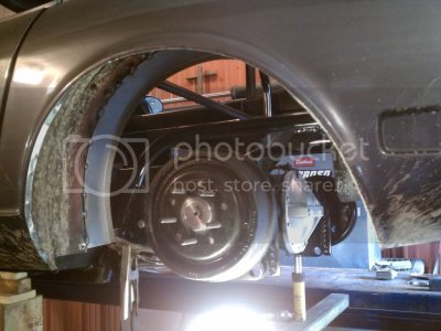

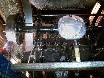

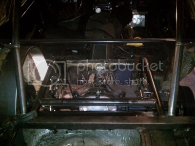

and a few shots from the conversion process.
IMAG0074
IMAG0070
IMAG0073
in this one you see the finished set up and can see the 2x2 box steel frame we welded into the original unibody "frame rails"
IMAG0080
the best part is no flares or indication other then the fact the tires are wider then the stock wheel well could hold originally. as seen in this mock up photo.
IMAG0051
