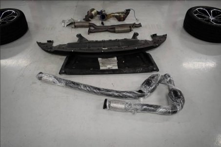

1) Upgraded turbo piping and cold air induction from Ecopower.
2) Livernois Down Pipes
3) On waiting list for Gearhead Intercooler
4) Also plan to get the thermostat, bar map, spark plugs and Gearhead tune.
These will help your turbos flow better, thus making them more efficient.

Those are basic upgrades for this platform and historically are perfectly fine with a good tune. If you are going with Gearhead then you will receive their auto octane tune which is rock solid.
The upgraded hot pipes and intake system from EPP isn’t just for looks for power increase. The stock plastic tubing is known for boost leaks which can put undue stress on the turbos to maintain boost. So they help significantly.
The down pipes will help the turbos breathe easier and should also help reduce the heat on the PTU. You may need defoulers as the LMS downpipes will throw a code. Gearhead will not modify emission equipment. EPP catted downpipes will not throw codes if you haven’t already purchased the LMS ones.

You did give me a new concern now with the LMS downpipes, I bought the catted pipes and I thought only the non-catted would throw a code.
I will make sure to get an inspection before I do the install. This way if I have an issue I have some time to research what a defouler is, lol.
UPDATE.
I was able to get a refund on the LMS downpipes from CARID.
Now I can get the EPP catted pipes

Ok, but the comments above had me recheck the LMS pipes and they are for off road and I did not see that, otherwise I would not have bought them. Glad to have caught it while I could get a refund. I am now leaning towards these PPE downpipes. More expensive but 49 state legal.

I had PPE Downpipes on my Ford Flex as well as a 3 bar sensor, 10gpm methanol spray nozzle and a Torrie tune.
I did not have any drivability issues nor did I get codes from downpipes for the first 30K I had them on. Once they coded Torrie just turned off the code in the tune.
