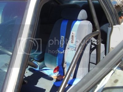

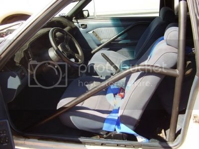

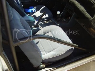

Blue interior!?!?! that's my second favorite color after red in 80s cars.

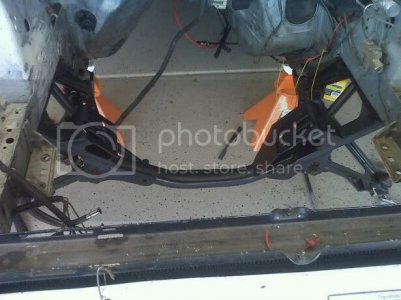

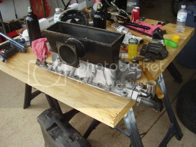

it looks good man. which direction are you going with that big empty space between the fenders?
Off Road SHO
Moderator
Jan 16, 2002
5,684
1,292
Chuck,

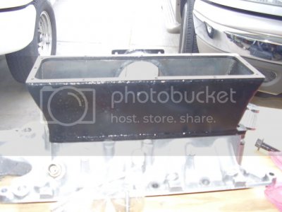

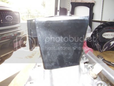

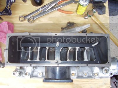

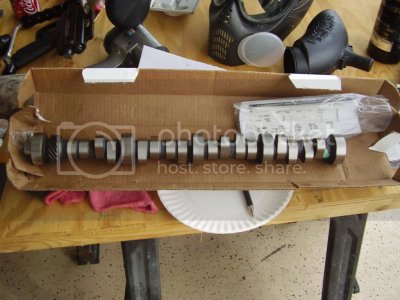

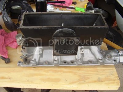

If that is a high rpm cam, are you planning on knife-edging between the ports on that lower intake?
What rear axle ratio has that got in it now and what will you end up with?
Tom
ChuckD
D, H, C
Jul 9, 2004
280
El Mirage, AZ
That intake combo is good to 9000. As it sits its Rear has 3.55s in it but that will change. That cam is good for 6500 but it will work till I get one from Jay. I am only planning around 8000. Motor should put me in the 10s, spray will get me in the 9s. Might need to buy some time in your shop with the welder. Taking some time off from it I just had knee surgery.
