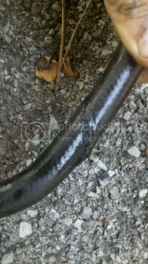

The old line is off the car and its mostly fixed other than the bent right strut. I seen the line and even helped take it. The only damage to it was clearly from the donut shredding and slicing the rubber hose on the line. Ill post a pic of it tommarrow probly...

The culprit to my tranny fluid spill.
2011 06 27 19 39 49 742
2011 06 27 19 40 56 749
I can't believe the wire from the donut made it that far to cut the line.
